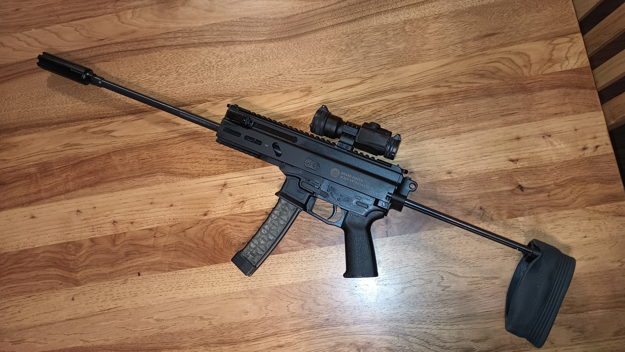

Grand Power Stribog SP9A1 may be the last PCC I'll purchase in my PCC quest!  Yup, it's that good.  For those who aren't familiar with Grand Power, they're a Slovakian company.  They're allegedly pretty well known in Europe, less so in the US.  The Stribog SP9A1 is a Slovakian military sub gun based PCC sold in the US in pistol format, with an 8.5" barrel.  Mine came from the online retailer equipped with a Grand Power PDW 2-Postition Collapsible assembly w/ Tailhook brace, three magazines (two straight and one curved) and a hard case.  The pistol itself came equipped with flip up polymer sights, plus an extra pair in the case -- which I assume means they might be somewhat fragile.  My price out the door was $949, though there are cheaper models in pistol format ($650 street price) and another with the SB Tactical folding brace ($725 street price).

My initial impressions was that the gun was a touch heavy, at 6 lbs. 4 oz w/ optic and brace.  However, that's probably to be expected as the upper is made out of extruded aluminum and equipped with a massive blowback bolt.  Everything also seemed tight, really tight.  Which meant that charging, field strip, et. took a surprising amount of force.  However after 250-rounds downrange things started to work a little easier.
Overall length is 25" with the brace extended and 17" with the brace closed -- plenty small enough to fit in a backpack or laptop case.  This is the kind of thing I've been looking for for sometime now -- a reliable, collapsible PCC that fits in a backpack.  Breakdown on the pistol is as easy as separating the upper from the lower and removing the back plate off the rear.  The Grand Power collapsible brace assembly, simply attaches to the gun by sliding on in place of the pistol back place.

It turns out there are (were?) two different collapsible braces sold by GunZoneDeals.com for the Stribog SP9A1:  One made by Grand Power, and one made by a company called Safety Harbor.  As you can see in the photos below the rods on the Grand Power unit are a little lower that the Safety Harbor unit.  As noted in my original post, my AR height optic was a little high with the Grand Power unit.  So I imagine folks using AR height optics might want the Safety harbor unit.
I do have a complaint with Grand Power OE unit:  The attachment between the attach the tailhook to the rods started to loosen up.  After consulting with the gunsmith at the importer, I replaced the roll pins which attach the tailhook to the rods with solid steel dowel pins.  I also added a little JB-Weld to the connection point as well.  Rock solid now.
