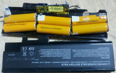

For those that haven't seen a Lithium ion ,Li-ion (Lion must be a British thing) cell in a steel case, check inside a laptop battery (except some Apple laptops).
OR, do a Google search for 18650 cells.  Or, sneak a peek inside your neighbor's Tesla
While there are various chemistries within the general Lithium Ion chemistry group they mostly rely on the electromotive force of Lithium.  Some are 'safer' than others in that when they overheat they only produce gas that expands, but is not an explosive gas.

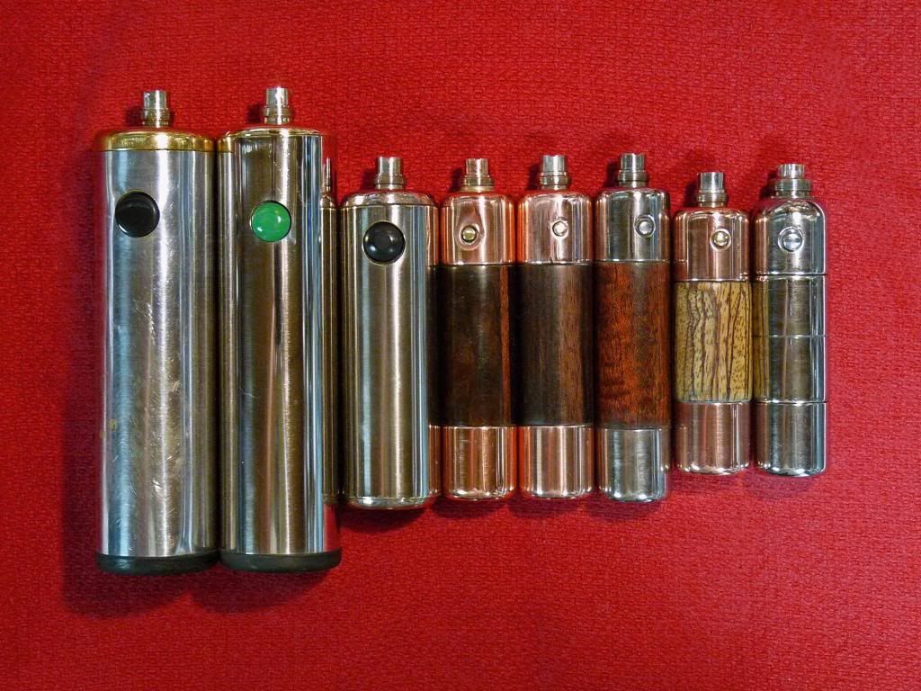

and I never leave my LIon vape pack in the Lincoln for more than 25mins
while charging on the dash in the hot sun. :)
