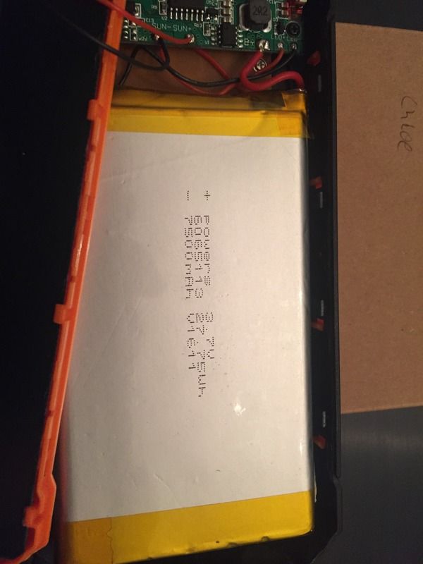

I got the second pair in. They are marked ToHLo brand. The solar panel works, as the charging indicator starts flashing as soon as you put it near any light. There was a small surface charge to begin with. Identical units to the other. But...seemed to charge a little quicker than the last. I put both new units on the scale. They weighed within 20 grams of one another, I put the earlier unit on the scale and it weighed a solid 60 grams more than the newer units. So, faster recharge times, lighter weight, same specs....something tells me that there is a difference in battery capacity here.

RV, you owe me a nickle.  8) I gotta get something out of giving into your OCD.
Survey says....Ta-dah! 7500mah, on 15000 advertised unit. Yup, fraudulent numbers. Still, 7500mah ain't bad.

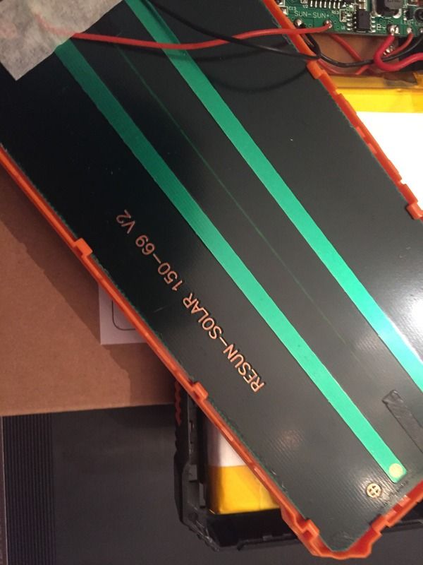

...and the solar cell.

I opened up the ToHLo. No markings on battery. Same solar panel. Appears to be same charging board. The battery in this unit was thinner than the first.
If you were to take both batteries and lie them flat on a table, the length and width would be identical. The cool buys would stack about a 1/4 " higher off the table. It appears that the battery pack is parallel flat cells. Two cells in the ToHLo, Three in the Coolbuys.
