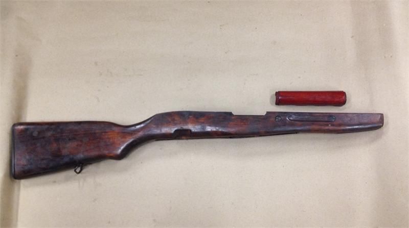

I am as well! This is the first project I am attempting like this. I have built a couple ARs but that was with all brand new parts, and for the most part already knowing what the outcome would look like. Now I am searching for used parts and hoping they are not damaged and unusable or that they fit correctly. I know stock fitment depends on receiver and barrel but I do not know enough to feel comfortable ordering a stock that isn't a romy

Your Cugir will also fit into any Russian or early Chinese stock. Later Chinese used a short lug or pinned barrel cutout on the stock.

Thats about the average price range for a stock in good sound shape with all the metal parts still there. Russian stocks with the pretty red shellac finish will price higher. Rommy Stocks usually are well used and have been refinished with occasional repairs, and heavily shellacked. If you really want to bring you rifle to its original glory, keep looking till you find a nice Rommy stock for it. But if you can't find one you like, next best thing would be a Russian stock.Stay away from any stock that had all its metal parts removed, it will be much harder to find these parts and fit correctly.

I thought about ordering this one from sarco, it is listed ar Russian, but the first review on it the person said they received a Chinese stock and the colors were a lot lighter. Things like that are what give me hesitation on trying to bring this back to life. $60 is not a lot, but its a lot to spend on something you don't want

Thats not bad for a Russian. Give Sarco a call and make sure thats the one you are buying. Sometimes they use a stock photo, so you may get one slightly different form the photo.
