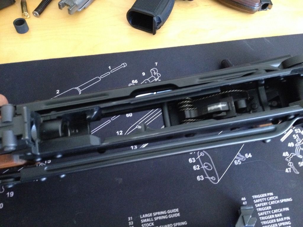

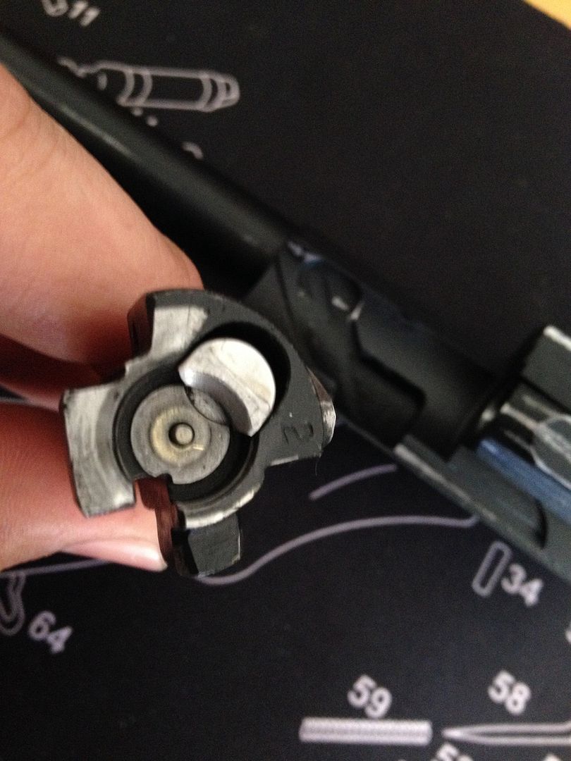

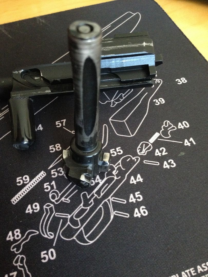

normal looking wear patterns.
The finish is holding up pretty good.

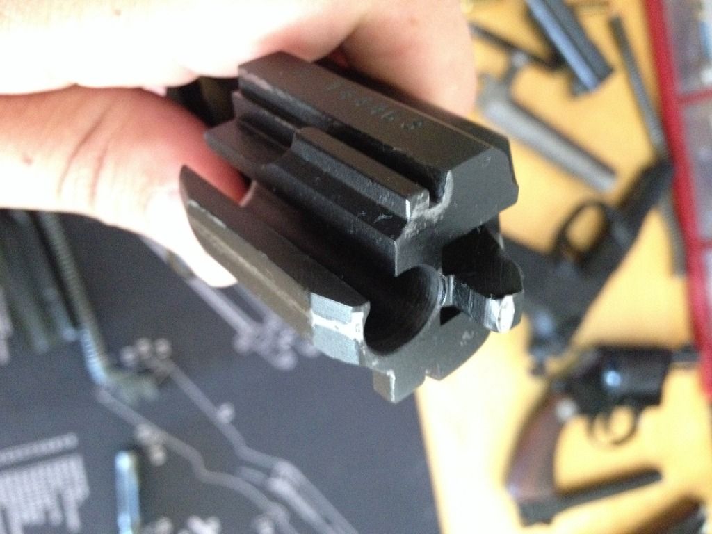

The bolt doesn't have any deformations.

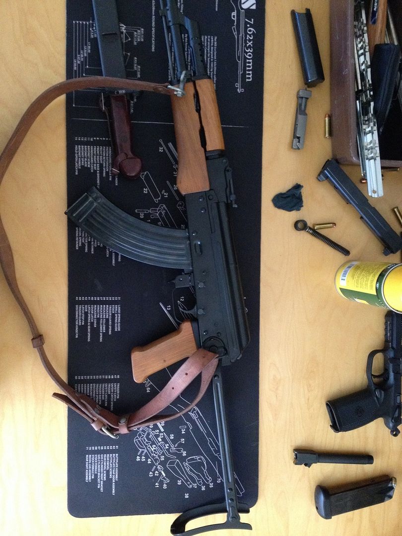

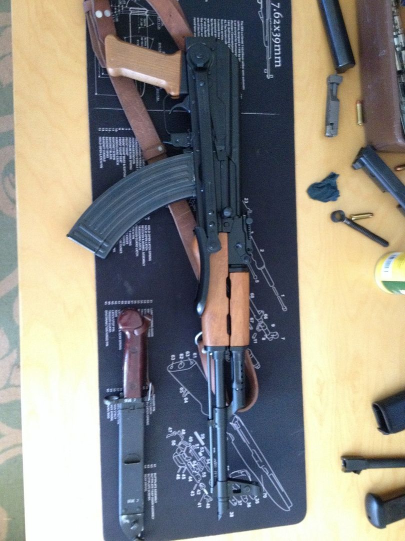

« Reply #2 on: April 25, 2016, 01:52:23 PM »
It's been a great rifle so far.

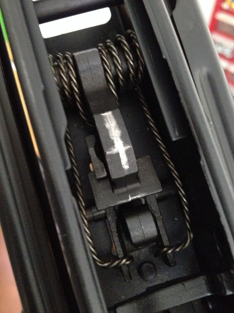

« Reply #9 on: June 26, 2016, 03:30:59 PM »
It certainly gets hung up on the hammer.
This is supposed to be flat, right?

« Reply #11 on: June 28, 2016, 01:26:38 PM »
Mine does not hang up but I was considering doing this.  After about 2500 rds I see a small peen starting on the safety nub.  I am going to replace the surplus spring and grind the hammer to correct it before the peen gets bigger.  Thanks for the link.
I like the century hammer, has a better profile.
Hey brawny,  also check the fit of your dust cover.  Sometimes the carrier can drag on it causing them to be more prone to hang up. It should not contact the carrier at all.

« Reply #13 on: June 28, 2016, 05:30:30 PM »
Polishing the hammer worked. I can't even make it hang up now.

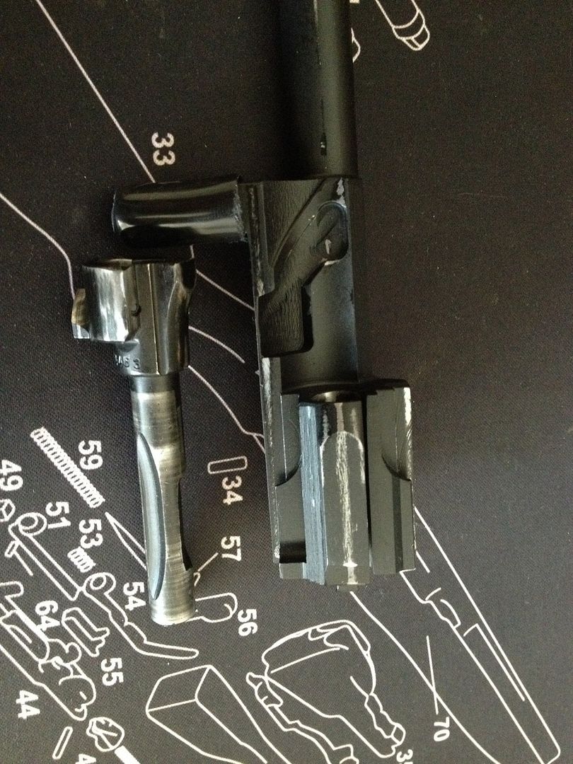

« Reply #14 on: June 29, 2016, 06:14:02 PM »
Hammer job before
After
