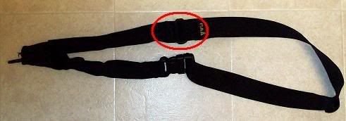

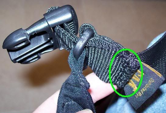

The pic below is of the CAA sling before alteration and the area circled in red is where I started.

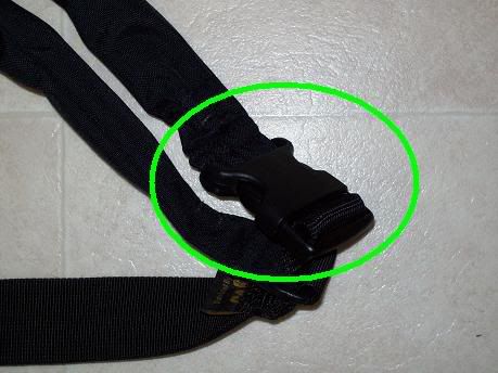

The pic below shows the male end of the quick connect threaded thru with the misc. webbing I had on hand and the TAG end then sewed in place where the green circle is.

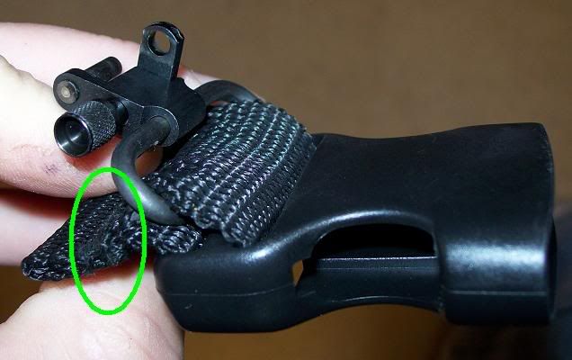

Next I took the female end of the clip and another short piece of webbing and a Fast Connect Sling Swivel. Threaded the webbing thru the clip and the sling swivel as shown and sewed the tag end where circled in green.

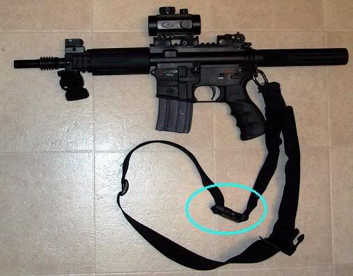

Below is a pic of the firearm with the CAA sling in single point mode and the female end of the clip already attached to the front for a quick hookup.
The area circled in Blue is where the quick connect will be disconnected and attached to the front sling mount

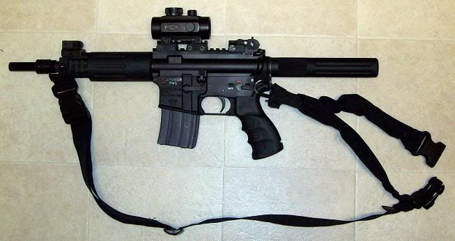

Once connected to the front mount you have this (pic below) with the remaining and original to the CAA sling Female end left to hang.
Now you can simply connect that remaining Female end to the Male end which was the first thing done in this conversion. Not needed but cleans up the whole act plus gets it out of the way.
The double point sling has a large adjustment to it that allows many different ways to carry as well as switching back to the original single point design.
