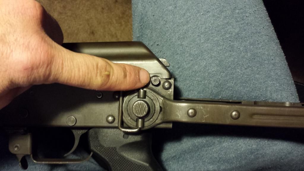

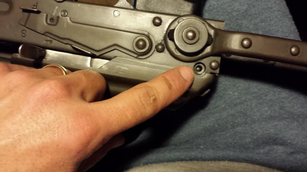

I noticed that the machine screw seen in photo 1 is missing the nut on the opposite side seen in photo 2.
This is part of the release mechanism for the receiver cover on a Zastava M70 AB2.

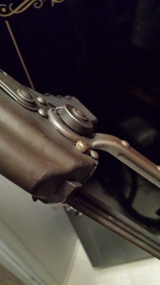

Here's the rest of the story.  Century Arms had me call APEX which informed me the only way to get the missing nut was to buy a de-milled Rear Trunnion Assembly W/Trigger Guard for $89.00.  I decided it was time to go slightly redneck and dug through my stash of machine screws where I found the acorn nut you see in the picture.  Looks like a natural.  I added some Lock-tight for security and I'm good to go.

Re: Missing receiver cover nut on Zastava Underfolder. SOLVED IT
« Reply #6 on: January 29, 2015, 09:29:26 PM »
The nut on originals is staked at the bolt shank & nut to prevent the nut from loosening. If staking a CNC unit be careful of the nut as they are kind of brittle and can shatter while staking.
