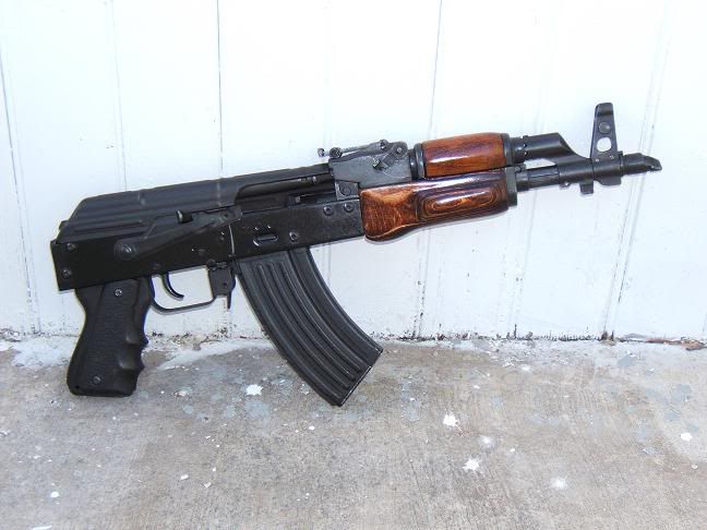

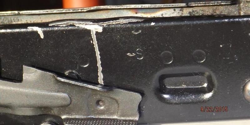

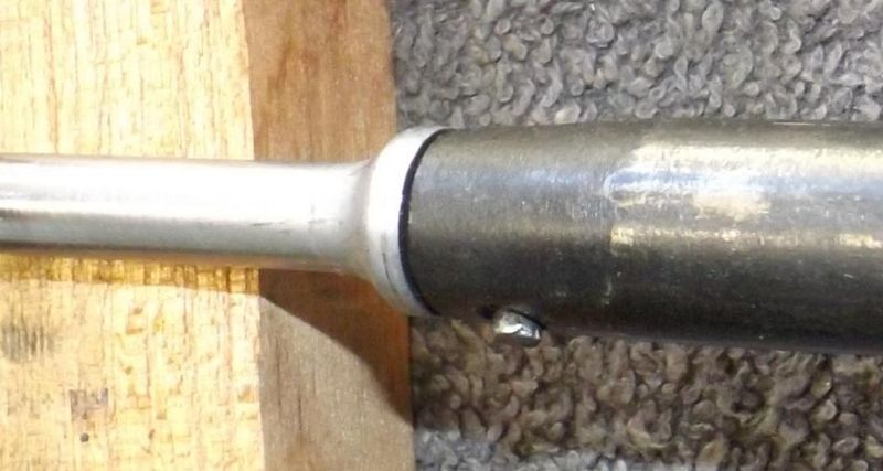

Before I fix this in my little weld shop I'm trying to figure out what has gone south.
Really don't want to do the repair before I know the cause kind of thing.
Some facts first ...
1. Head spaced but MM trunion to bolt. (Bolt and carrier do match).
2. OOW receiver. In fact the ONLY receiver I've used in a build that I didn't fold from a flat.
3. Pistol build .... over gassed? It does chuck a steel case a bit farther then a standard rifle but I wouldn't call it excessive.
4. Yup ... it's cracked.
Thoughts appreciated.

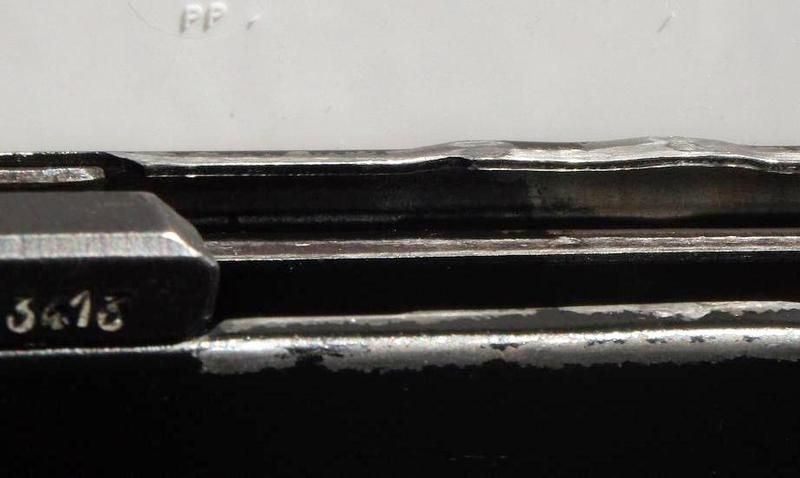

OOW receivers of the older variety., like the flats are not heat treated.  They are soft and can warp rather readily.
However, having said that it is unusual for the type of deforming shown in your picture.
Over gassing could be the culprit.  How is the headspace?  Is the rear trunnion block getting battered by the carrier?

Without handling or working with it the example above would be one basic indication.  It would be uncommon to see a fully hardened receiver bow in that manner.  Of course not knowing all the build and set up of that irregular build is an unknown.  It has a cut down barrel, unknown barrel port size, screw build etc.
The example above shows pretty much bare white/silver metal where the paint has lifted which is somewhat an indication of a non heat treated metal surface.
On a non fully heat treated receiver that is in the bare or "white" one could readily see the rainbow/halo effect around the axis pin holes on the receiver where the spot heat treating was done.  Fully heat treaded receivers do not have this and are most often darkened as the salt bath and cooling process turns the metal from the untreated silver look to the grey/black finish.
If one were drilling or dimpling , or otherwise working with the untreated receiver it would be obvious in the softness and lack of hardness and spring like return to original shape when flexed.

Well I checked my notes for this build.
I found mentioned that the initially port size was U/S and caused a failure to extract and feed reliably.
Although the size wasn't listed my notes they also included that I went up one size using my number drill index.

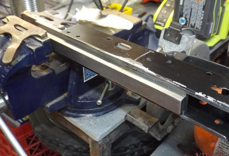

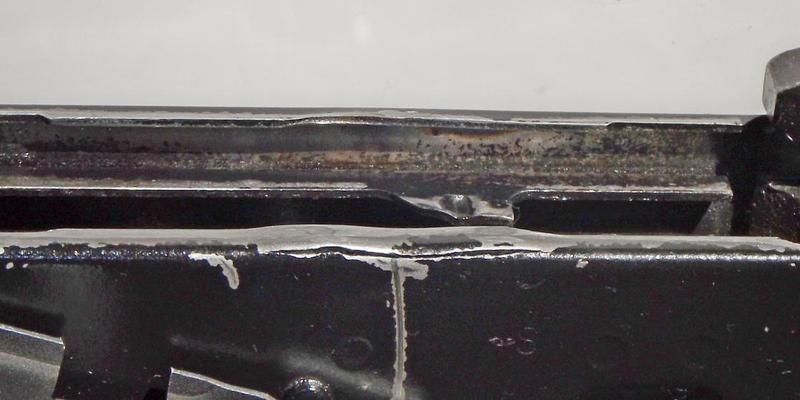

After reviewing the rest of the firearm as a whole I noticed that the retaining pin that holds the piston secure onto the carrier had worked loose. There were marks from contact made from it on the inside of the rear sight block. (Left Side)

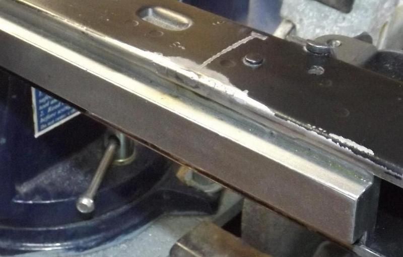

When I would move the carrier assembly rearward to the location of the marks being made so that they would coincide with the retaining pin the damaged rail was directly in the middle of the short slot on the carrier that rides that rail. I don't think this is coincidental.
The 1" crack has been reshaped and welded as well as the the retaining pin for the piston repaired.
The carrier rides the rail nicely.
I have no problem testing this once back together or shooting many of the other stamped receiver firearms (non-AK) that I own. But thats not what this is really about.
The gas block ... I didn't bother to drift out the two pins to remove but is a possibility.

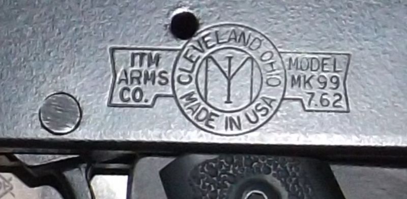

Indeed this is an early ITM MK 99 receiver.
I've read they were mostly made for OOW and the reason that I initially called it an OOW receiver.

ITM built the receiver for OOW. Later I believe OOW got their license to have their name on the receiver.
Like the Nodak Spud (NDS) receivers were originally marked DCI (DC Industries),
That is a non heat treated model.
Appears you found the issue of the jamming piston.

I'm thinking the problem is solved too AKBLUE.
 It's back together and ready for a test run.
I did notice too that a grip plate looks like it will be added as well soon.
Guess with that soft receiver and the one handed hold used there is a lot of stress going on in the area of the grip nut.
Nothing so dramatic as the rail anyway but needs to be addressed.
