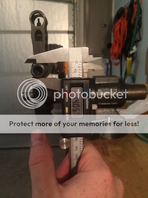

Measured the diameter of the muzzle before I started I made sure my digital calipers were correctly calibrated in inches. All measurements were taken in MM.
Here's a few shots of what the muzzle and crown look like.
I took three horizontal readings front, center and rear right before the barrel steps up.
I also took 3 vertical readings and the numbers were a bit different.
Re: Threading a MAC-90 barrel
« Reply #8 on: May 24, 2016, 07:19:21 PM »
Based on the setback of the FSB and the shoulder that exists in the front of the FSB you will need a crush washer etc., to fill that gap.  If you do fill the FSB for a plunger you can notch the washer etc.
The .5488" barrel diameter is good to go for 14mm x 1 pitch threading.
