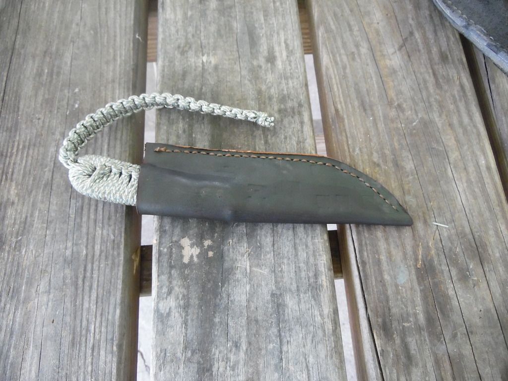

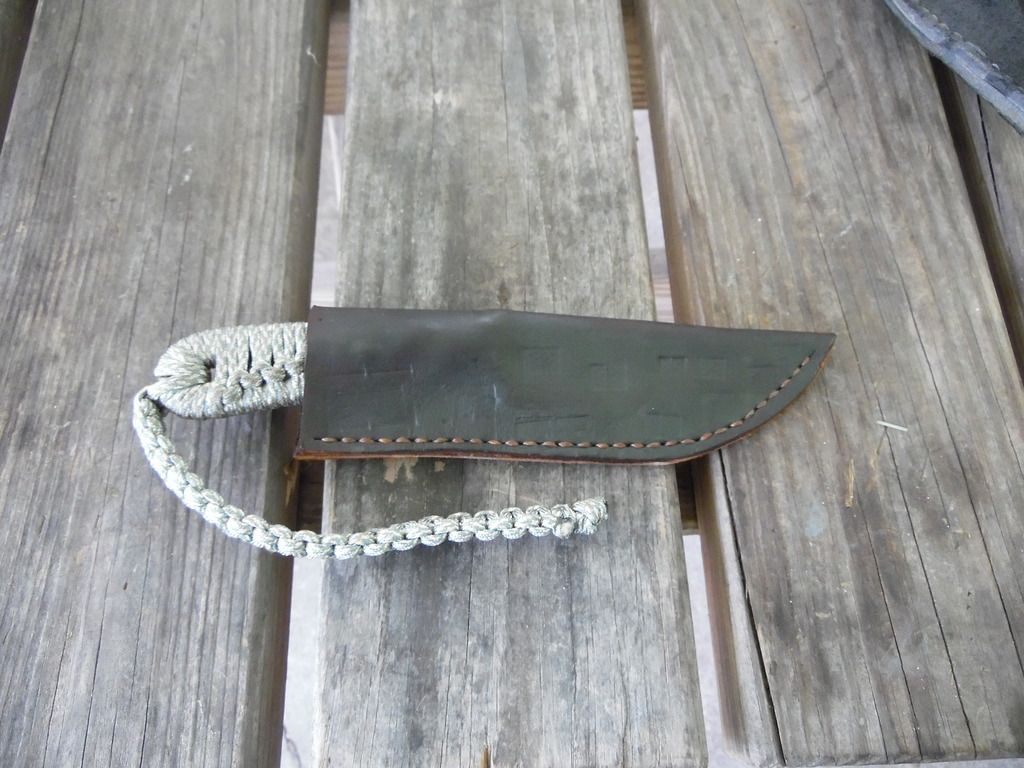

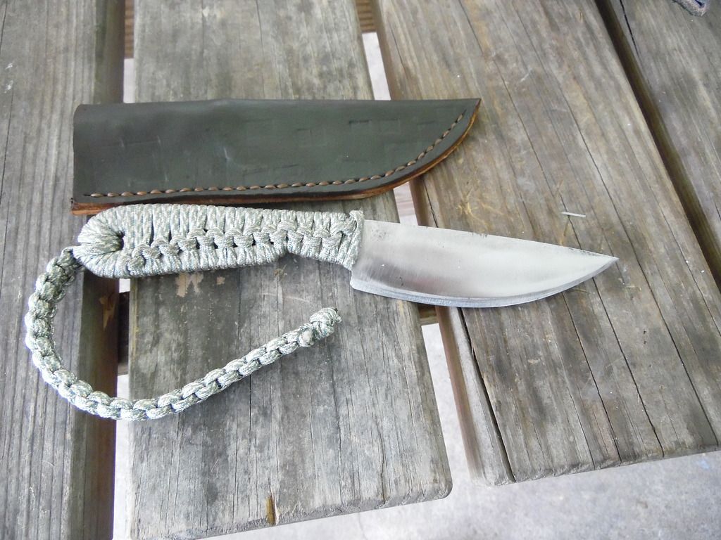

this is one made out of 1095 spring steel out of a car leaf spring,it is 9 1/2 inches long full tang wrapped in para cord digital camo hand stitched leather with no clip (ambidextrous) carry very sharp. What you all think?

first time 3 days. then i had to back and redo the blade again after the metal cracked it and been quenched to quick. 2 time it took me a week with the same blade :banghead:

on the first quench I used vegetable oil, guess it was too light; second time around I used motor oil 10w40 and then hardened it more at oven temp at 400 degrees for an hour I mostly learn as I go and had to ask my friend what could've cause it to crack . he gave me 3; cooled to quick, to light of an oil or water got on the blade while forging.

Preheat your quenching oil to 250-300 degrees before quenching. Otherwise you can cool your blade too quickly. Veg oil should work just fine.
The only real difference in mineral Vs vegetable oil quenching is the price unless you use grease. I've heard of beer, brine, water, and lard all being used also.
