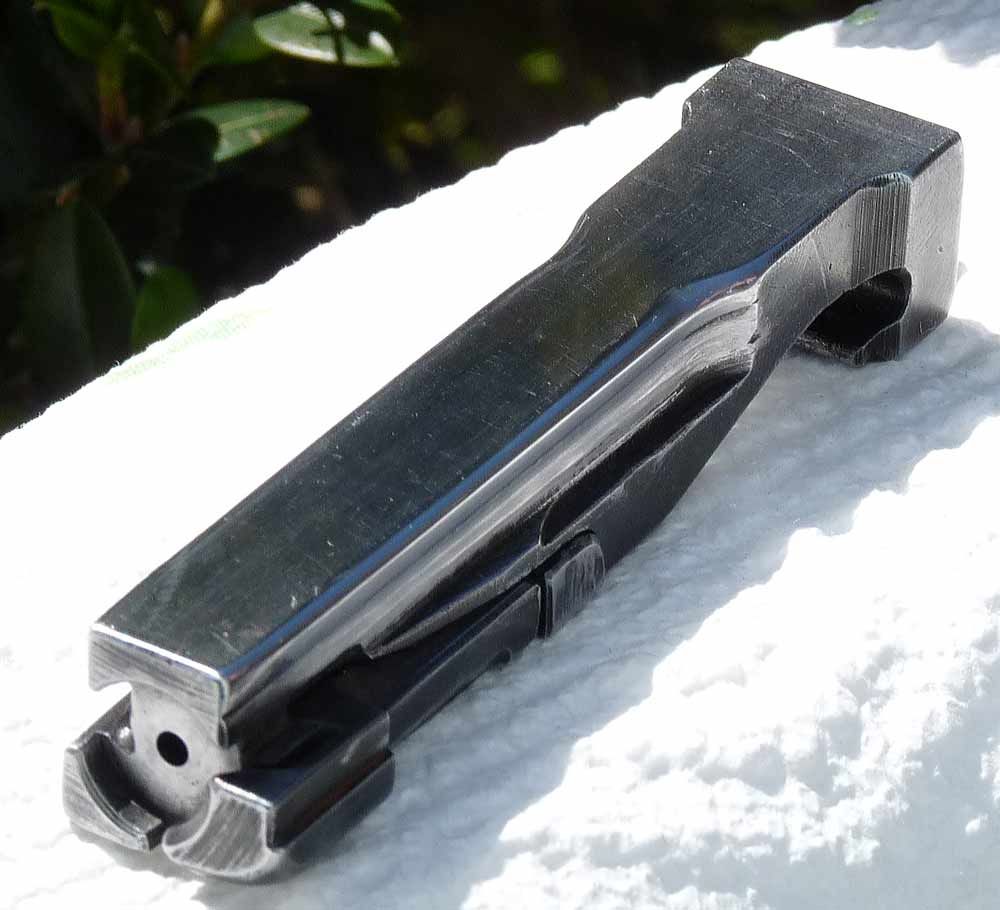

Just grind the regular bolt.  https://www.youtube.com/watch?v=MV1QR6bRdUc
Re: My first mod on Chinese SKS rifle. Bolt carrier and bolt replacement.
« Reply #11 on: October 18, 2023, 11:41:09 AM »
What would we do without YouTube :)
Drop free mods have been done right here on this forum since about 2007.
The bolt in the video has SHARP edges and will EAT plastic mag lips.
I like mine better (picture is from 2013)
Besides, the supply of M /D bolts is likely pretty limited.
« Last Edit: October 18, 2023, 11:59:58 AM by Rocketvapor »
