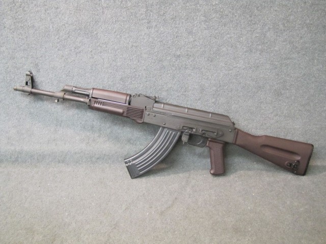

The best "detachable SKS magazine" is shown below.   :roll:  :)
But seriously, aftermarket mags are hit and miss, so tweaking the mag is typically involved.  I'm not so sure I would do the bolt mod.  Once you do, the rifle is no longer "stock" . . . but it's your rifle, so in the end it's up to you.
If you're like most folks, I'm pretty sure you'll eventually return their SKSs to stock form.  Many go on to pick up an AK as their second rifle . . . provided your not in a ban state.
