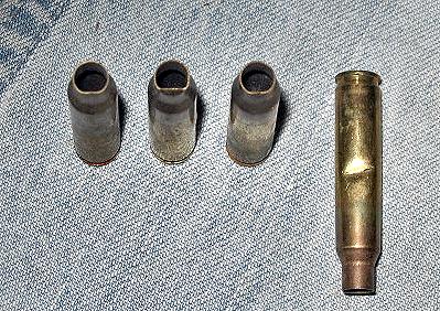

The brass will have the rims dented if its cycling right. They come out during ejection off the ejector nub on the receiver rail  spin around and hit the receiver cover and put the little dent in them.  Its the dents and scratches in the middle of the case that will be a clue to short stroking.
The 3 you see are what they look like some dent a lot some hardly at all. Just depends on how hot the round is and where it hits.  This one with the dent in the middle is a double or misfeed from a mag that the bolt hit on the side IRRC, just for comparison.
It has to be extremely dirty to not run, but if there is carbon around the outside of the gas tube anywhere, that may be where its leaking enough gas to make it short cycle.  Though I think that a very rare in any AK, it doesn't take all that much gas to make it run. Once it starts a lot is done with the inertia of the weight of the bolt and carrier.
That's the mark!
