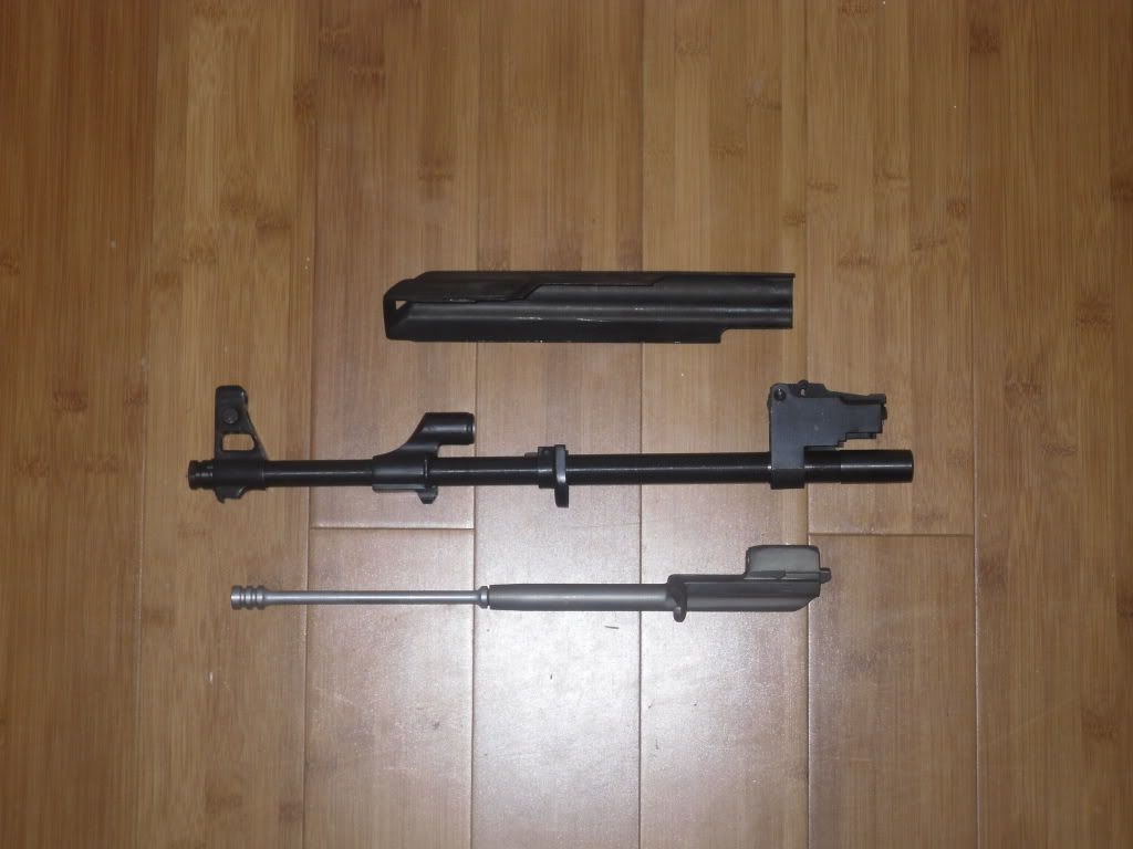

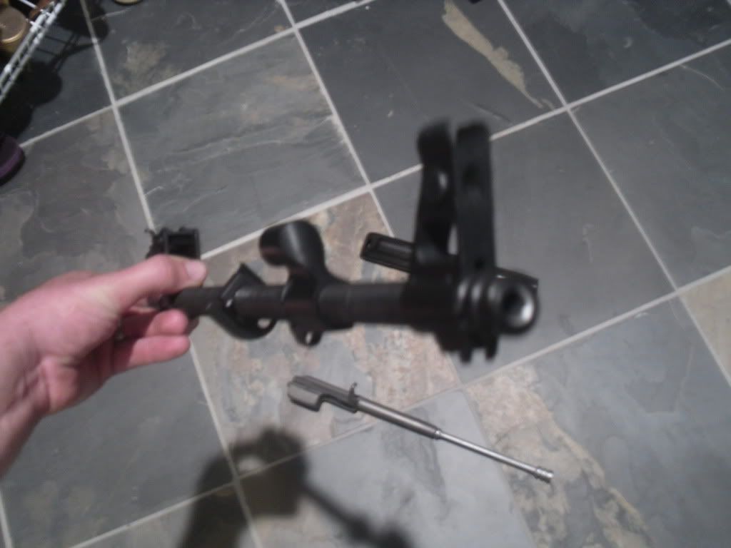

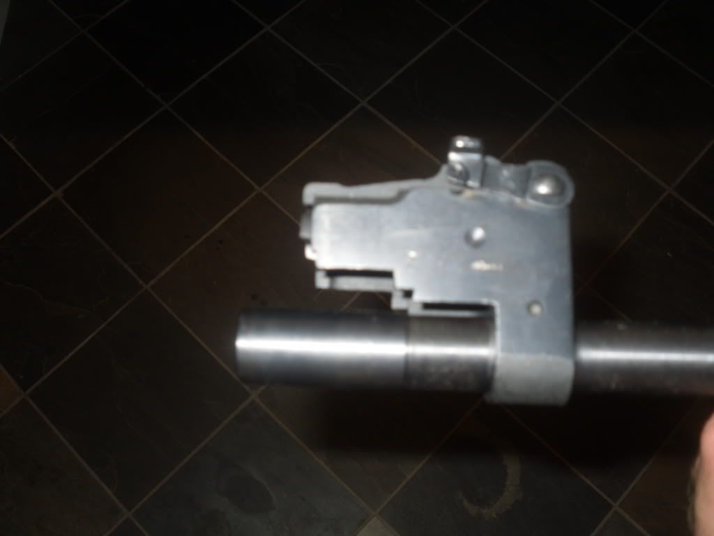

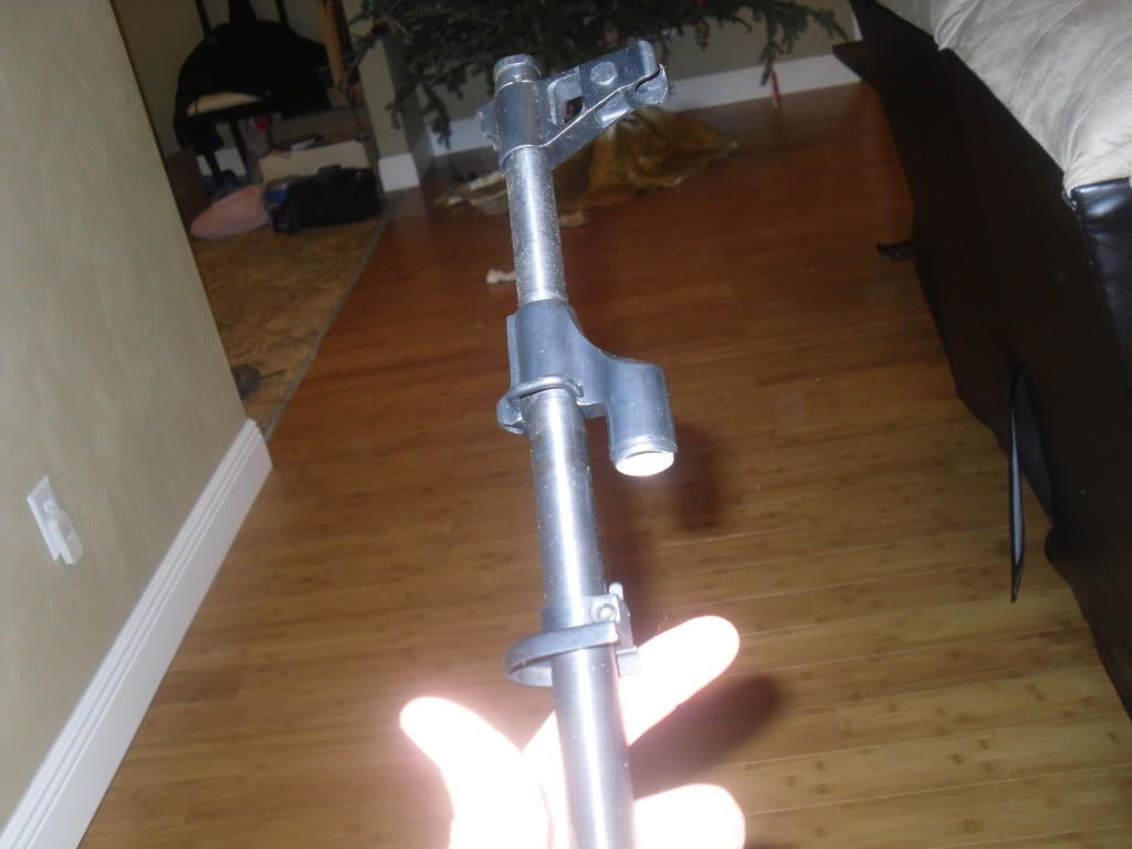

Went to PA for one week to visit family and happened to stumble across this parts kit...came with everything (missing gas tube, though).  What's strange is that there was no serial numbers on any parts, it is all brand new equipment, each spring and pin was in a separate baggie with a small piece of paper labeling each part , the quantity and stating, "Made In China."
I assume this to be Chinese also because it has no bayonet lug and it has that weird little muzzle device put on where a brake would usually go.  There are no markings on the barrel other than some randomly placed #2's and one #7 and one #6... :?
Not sure if the barrel is Chinese or USA, but the barrel under the sight block is not notched out for a barrel pin and the kit did not come with trunions, so is this for a milled reciever?  Is this Chinese??  Please help me figure out what I have since I was under the impression a Chinese AK kit was non-existent.  Here are the pics.  Oh, and I paid $75.00 for this.  How did I do??
Sorry for the poor picture quality.  I'm a bad photographer and have a $60 camera, so there ya go.

Chinese barrels have small journals (diameters) compared to other AK variants.  Hard to impposible to find a trunnion for them., but you my stunble over one somewhere.  The sum of the missig parts may be pretty expensive.  Were it me I would try to sell off the parts.  Should be able to sell them and make a few dollars.  Or you can cast about and hope to find some parts and a receiver.  Good Luck :lol:

It appears you have a Chinese barrel assembly.  You can also tell the difference between a Russian/Euro pattern by looking at the front site base.  Kits aren't non-existent, but not common.  Many Chinese rifles, including others, saw the torch due to police confiscations, etc.  Some folks bought the cut-up kits and re-sell them.
The barrel assembly doesn't have a "lug" in terms of how you see one on an AKM style rifle as that particular front sight base and gas block is configured for one of the early First Model bayonets (the old ones with the "spear point").  I'm not sure about how well or poorly you did with the purchase but you're going to have a heck of a time locating a Chinese trunnion for it, as mentioned by AKBLUE, as well as a proper Chinese rear sight leaf for the rear sight base.  Polytech parts may have the rear sight leafs and parts, though.  And, you'll have to find a Chinese receiver to use it with, although you can make it work with others.  You may have bought something that you likely can't do anything with.  You might find someone in need of one for a project if you list it for sale on an auction or the like.  But there's a couple of Chinese barrel assemblies that have been on Gunbroker for a long while with no one bidding on them.

You can use a Chinese stamped receiver for that barrel assembly but finding a trunnion for it will be near impossible. It's meant for a milled receiver and would look better on one.  The trick is going to be to find a decent Chinese milled receiver.  If you choose a MAK-90 receiver, you'll likely have to deal with a slant-cut at the rear of the receiver, if that bothers you or not.  An separate, non-cut Chinese receiver will probably be very rare or an already built rifle.
You can definately work toward building your Chinese rifle on a US-made milled recevier, though.  It's going to be an expensive process - price of a milled receiver, obtaining all the parts (if you don't already have them), and the cost of the build.  Basically, a milled Chinese AK build from a kit is not for the faint of heart.
If you're planning on building the kit as a milled rifle, may I recommend doing it as the very uncommon "M22" instead of essentially making a clone of a Polytech Legend by using the existing, complete barrel assembly.  If you switch out the front sight base with a "hooded" front sight base that also has the "fangs" underneath for the First Model bayonet (kind of like what you have on it currently), you'll be good-to-go toward the rare Chinese M22 (supposed "export version" but many had only the Chinese arsenal markings/characters and weren't just marked "M22") of the Type 56 rifle.  Certainly a unique project.  Here's some food for thought in terms of photos of M22 rifles:
