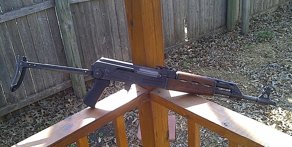

Got the kit from APEX a few years back and Matt Yeamans did the reweld.  This is one very nice and soft shooting AK, with the classic battle field look:

Very nice.  Not nearly as many of the M64 Yugo's as the M70 models.  Matt does some good work.
How is the bore?  Most M64's were not exactly pristine.., but shoot well.

Very nice indeed. Love that you did not paint or refinish anything.

How is the bore?
The bore is dark and nasty.  It passes the bullet test and shoots like a dream though!

Good deal.  They are smooth and rock solid
I have a M64 underfolder reweld with a nice bore.  The fixed stock kit I have is all matching and nice but the bore is really bad and swallows a bullet..  I'm going to pull a bullet and see how far/bad the bore is eroded from the crown.  If not too bad I may counterbore it.  I have another barrel but the threaded barrels are a pain to remove/install/headspace compared to a press & pin.
Then I'll send it off the Matt/Turbothis for reweld.  A welder I am not.

Beautiful rifle..I'm not a huge fan of Yugo's, but I love this one.
I know this sounds dumb, but what is the difference between an M64 and an M70?
