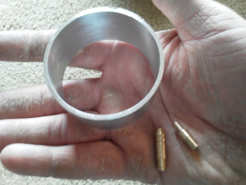

I will use a press as an expedient lathe though. The brass fittings here were made on a drill press.
