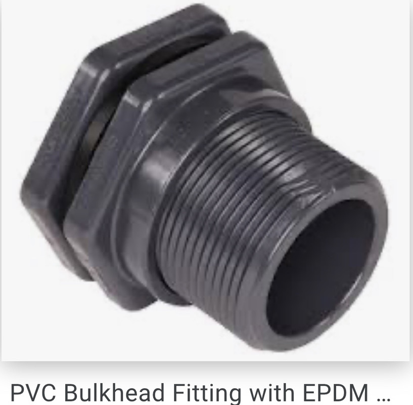

Because they are stacked I had to drill a 3” hole in the upper part of the bottom tote and install a bulkhead.
 There are other ways of doing it but they require a more elaborate piping and venting. This was the simplest and cleanest way to do it. What you can’t see in the pictures is the top. Both totes have a 2” threaded bung in the top. The bottom tote bung is sealed tight. The top tote bung has a 3 way pvc piece that allows water to flow in while also letting air escape through a vent. So the top tote fills the bottom one. Once they are both full the water goes out the overflow onto the ground just as the gutter would.

 LDSPrepper on YouTube has a series of vids about this. He tried it a bunch of different ways and I liked this one best. But he didn’t know about the bulkhead I mentioned which made it much easier for me. And no chance of leaking.
