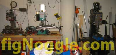

This picture shows the scale of the X2, X3 and RF45 mills. Notice the mass of the RF45 over the X3.  Note:  I borrowed this photo from fignoggle.com, where they have allot of info on smaller mills.
