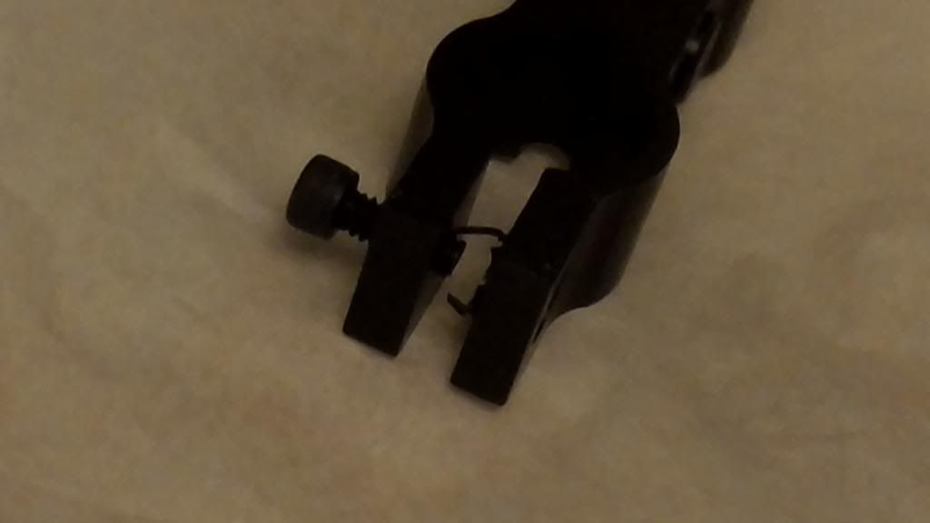

I have just tried to install your sight. The clamping screw pulled through the sight. Please send a replacement. I was looking for installation instructions and found only those mentioned in a review.

Lacking instructions, even on this forum, over tightening the thin sliver of shoulder the clamping screw rested on may have happened. I have installed sights before; on AR's and AK's. This is the first one that I have had one fail. I would expect stripped threads before this type of failure. Could be a simple defect (i.e. the counter sunk hole drilled too deep).

I hedged my bets. I was also a tad anxious. I was not sure if these were available anymore. I could use a button head screw, which would span the gap of the countersunk hole.

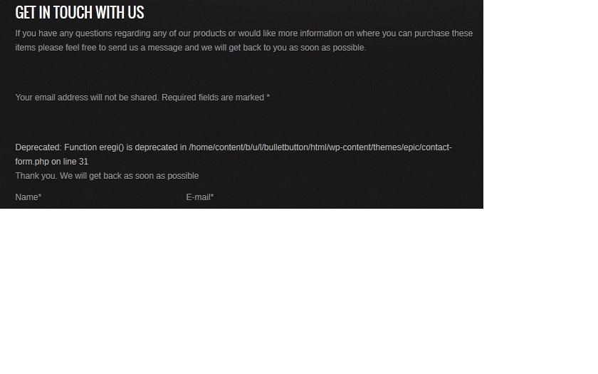

As evident in other posts, your response time is woefully lacking, if existent at all. In my initial contact, I sent a PM. I subsequently read (in this section) that you had not responded to PM's. The writer was directed to contact you. I proceeded to your website and found the Contact function. I entered all of the requisite information and clicked "Send Message"; to which I received this error:
Thinking the site may be experiencing problems, I emailed you via Yahoo. I was not certain which of the three listed on your contacts page was appropriate, so I CC'd the other addresses. Additionally, many of the links on your website list, "Description Coming Soon…...", which could easily be construed as either you are busy or out of business. None of my reactions were excessive, in light of the information I received.

Buckmeister, I had the same exact thing happen to an early version P50 sight I had. It never really tightened up, but merely pulled through the recessed area. I ended up using a button head screw like what you mentioned above and it did the trick quite nicely.
Just a friendly FYI, in case you decide you would rather not go through the hassle of shipping it back and waiting.

Send it back, and I'll send a replacement.
It is a very early sight. Gen 1 in fact, and the countersunk hole was SHALLOW! Too shallow to be exact.
WE will get you a Gen III and you will be very happy.
