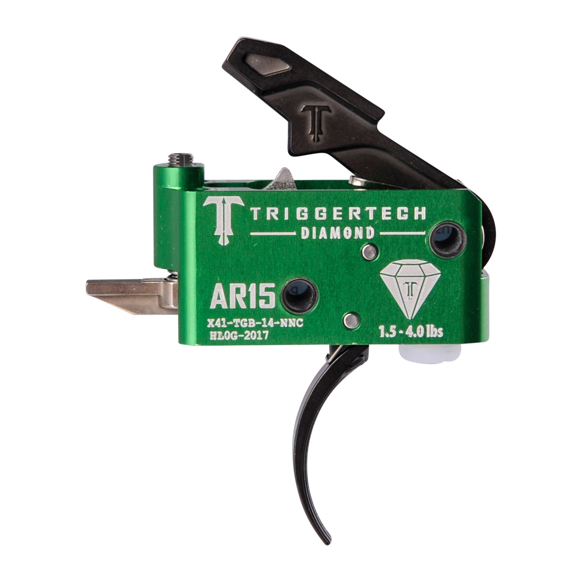

Triggertech, Diamond Adjustable, available in single or two stage is on sale at Brownells (Green exclusive) but two stage is sold out, for now.  $155 is about twice the price of the ones I've installed, but about half the 'Normal' price.
https://www.brownells.com/gun-parts/rifle-parts/rifle-triggers-parts/ar-diamond-exclusive-triggers/?sku=430103233
A review;
https://ultimatereloader.com/2019/05/17/tested-new-triggertech-ar-diamond-1-5lb-4lb-ar-15-trigger/
